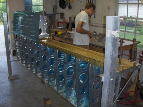

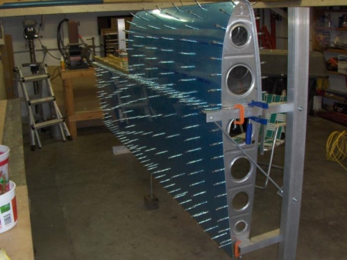

Today we got the right LE ribs clecoed in the skin. It was pretty tough, and definitely a two man job. We then tried putting the LE assembly on the wing, but found we had to notch our wing stands, like so many others before us. For the left wing we will use a larger piece of angle to further stand the wing off from the stand. See the pictures below for wing stand notching so the skins will clear:

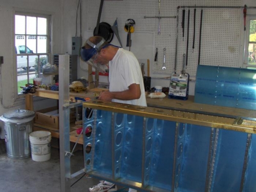

Next we fluted the W-408 rib and got the joint plate all centered up and clamped in place.
Joint plate clamped in place.
Finally, we match drilled, moved clecos, then match drilled some more. Now it's on to building the tank!
