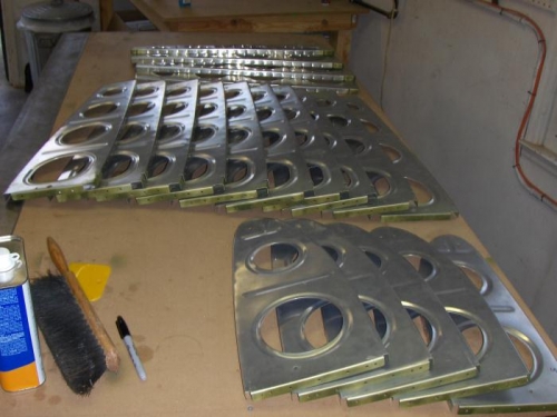

Fluting Ribs - 2 hours
More fluting / straightening here and there, a little over half way done.

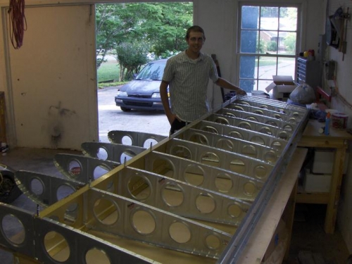

Right Wing Skeleton - 3 hours
Tonight was a milestone - I'm basically done with rib preparation. It took me what - 2 months? I was busy with other things and terribly unmotivated, but tonight all that changed.
Dad and I built up the right wing skeleton, checking and double checking and triple checking that we had the correct ribs in place since we were working off the left wing drawing. All holes have been match drilled and deburred and all the contact surfaces have been primed.
7/02/2008
Right Wing Skeleton Riveted - 6 hours
In the shop I started by enlarging all three forward tooling holes in the ribs to 7/16" for the 1/4" ID snap bushings I got from Aircraft Spruce. These will be for the Pitot / AOA lines and one extra for whatever. I also put in a 3/4" hole for conduit per the instructions. Dad did some detail deburring on the ribs and also deburred the newly drilled holes.
After a few hours of that, we got to actually riveting the ribs to the spars. We only had to drill out one rivet, which was placed where a flap hinge bracket would go.
