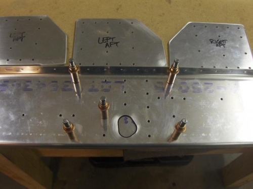

I started match drilling the W707-E and F doublers on the right wing spar. I haven't cut the aileron push tube hole yet.

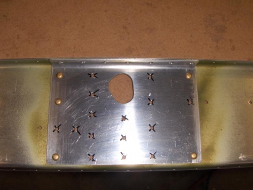

Today I finished the holes for the aileron push tubes in the W-707E doubler plates. I used a unibit backed up with a 2x4 to make a bunch of holes, then finished the holes off with files / emory cloth / scotchbrite. Each hole took about 20 minutes. I then deburred an dimpled in a few locations that need it. All the top flange holes on the rear spar that are above the reinforcement fork got drilled and dimpled, as you can't reach these once the fork is installed. I dimpled the top flange of the W-707E & F doublers and the corresponding holes on the top spar flange as well. I also dimpled the four most outboard holes on the spar and W-707F doubler instead of machine countersinking. Then I primed all the necessary places.
