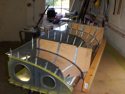

Leading edge ready for rivets, wing skeleton deburred - 3 hours
I worked solo last night, but got the leading edge clecoed together and ready to rivet on the next duo session.
Next, I removed the top skins from the wing skeleton, and then I then spent what seemed like forever deburring holes. There are a lot of holes on the wing skeleton. I also countersunk the remaining holes on the top side of the spar.
