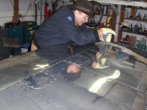

Right wing bottom skins riveted - 7 hours
Tonight dad and I got both bottom skins riveted to the wing. Lots of reaching long distances and "blind bucking" (bucking the rivets without being able to see them). All in all it went well. We did have issues with the gap between the bottom skins and the leading edge skin / tank skin early in the process, but we 100% clecoed the row of holes that attach the skins to the main spar and this helped - the gap is minimal and even non-existent in some places, and will easily be filled by paint. Now I've got to come up with a way to hang this puppy from the ceiling so it will be out of the way. The wing is 99% complete, not counting controls. So what's left to do?
* Inspection opening covers
* Wingtip fiberglass fitting work
* Build the aileron
* Build the flap
* Build push tubes for ailerons
* Rig controls to neutral
* Pull wires for wingtip lights
So it's 99% complete, 90% to go, haha. That's a pretty common theme with building an airplane. Anyhow, here's a picture of the bottom wing skins riveted.
