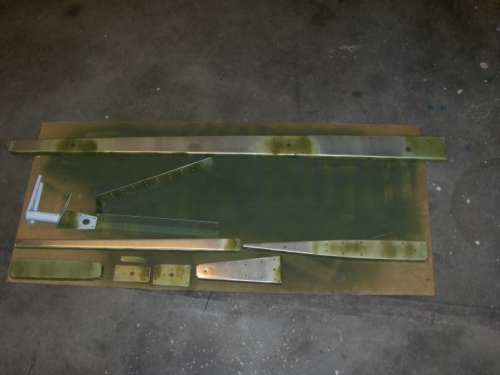

Left Elevator - 2 hours
Debur, dimple, prime.
2/17/2008
Left Elevator, Trim Servo, Trim Tab - 8 hours
I'm not done with the left elevator assembly, but a lot closer than I was this morning. I spent about two hours messing with the trim servo and deciding how and where to mount it. After much clamping, measuring, tapping, measuring, measuring, measuring, I finally drilled some holes and got it put together. This is the first electrical component on the airplane.
After that, I decided to try seeing how easy/difficult it was going to be installing and removing the servo. After some messing around, I decided to file a small notch in the reinforcement plate on the elevator to allow one corner of the servo to clear. Now if I maneuver it in the right sequence of twists and turns, it comes right out.
I used an angle gauge (wood working tool) to measure the approximate angle of the trim tab and transfer this angle to some wood blocks. Band saw, belt sander, and I had a nice set of forming blocks. I also used this method to bend the tabs on the elevator. I clamped it all together and then followed the directions and worked back and forth with a mallet and small wood block. It came out pretty good - not perfect, but acceptable. I'm building an airplane, not a show plane.
I continued to work on the trim tab until I was tired of standing up. I got the hinge drilled and the bottom mostly riveted. I think I'm going to have to use a pop rivet in the aft most hole on the control horn (where the cleco is in the picture). It was tricky squeezing those rivets, but the longeron yoke worked well.
