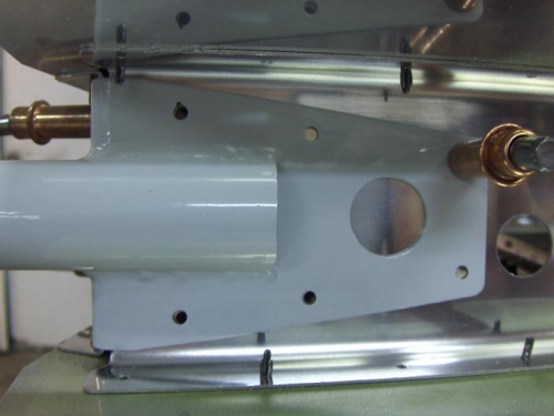

The response on VAF was that others experienced the same thing and that they tweaked the end rib, which is what I did. Here's a pretty good picture of the problem area. Note that the rib doesn't sit all the way down in the "valley" of the control horn.

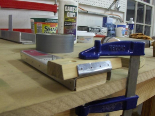

I cut a few pieces of wood and clamped everything to the table like so. I tried whacking it with my mallet, but ended up using the rivet gun with the flush set - that worked really good for tweaking the bend.
The holes started lining up better in the control horn and the rib / spar.

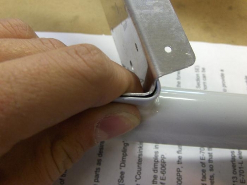

But the holes for the spar to rib were way off after this tweaking.
I decided to re-drill them instead of trying to force everything into place. I re-drilled and made a small doubler that will sandwich the rib flange with the oversize holes, so I think it will work out fine. The rib with the figure-8 holes:
