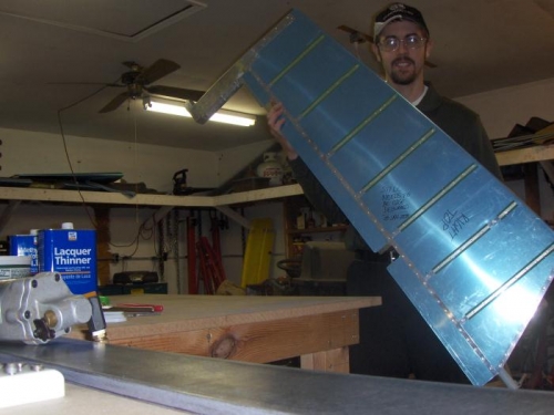

I spent quite a while today routing out one of my work tables to install the full-length back rivet plate that I made. I routed a 4" x 75" space in the table and it took forever! I started routing in the shop, but routing MDF creates a TON of dust, so I took the table outside to finish. Now I need to REALLY clean the shop again. Anyhow, it turned out great:

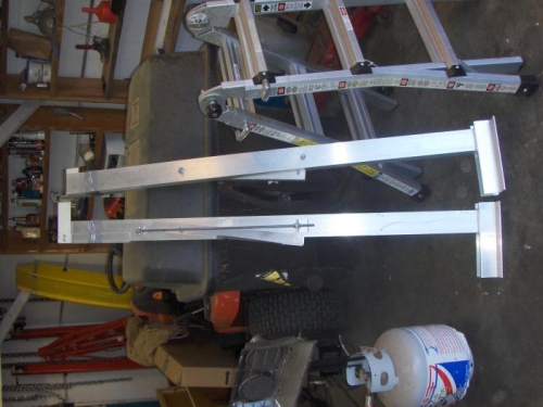

I also drove out to Auburn, AL this morning to pick up a set of wing stands that Paul Rose donated to my project. They are very nice, made from extruded aluminum.
So I back riveted the trailing edge of the rudder on my new back rivet plate. I followed the directions and weighted the rudder down to the table. I used some carpet padding and some railroad jacks for the weight.
I just took my time and spaced the riveting out and came out with a very straight trailing edge.
The shop heads of the double-flush rivets look good too:
