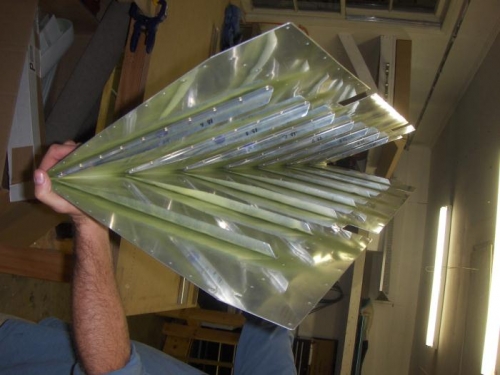

Today I took one of my bad rudder skins and a stiffener and drilled a #40 hole between each hole that is already there (the enlarged #30 holes). Debur, dimple, then I had a part to practice back riveting on. It only took playing around with the shortest stiffener to get the hang of it. Dad and I then back riveted all the stiffeners to the right rudder skin that will be going on the plane - piece of cake.
After that, I match drilled all the left rudder skin stiffeners to the skin, disassembled, and deburred. I was able to dimple the stiffeners, but will have to get to dimpling the skins next time. If I keep to my plan of working 3 days per week, I might be done with the rudder in 1.5 weeks.

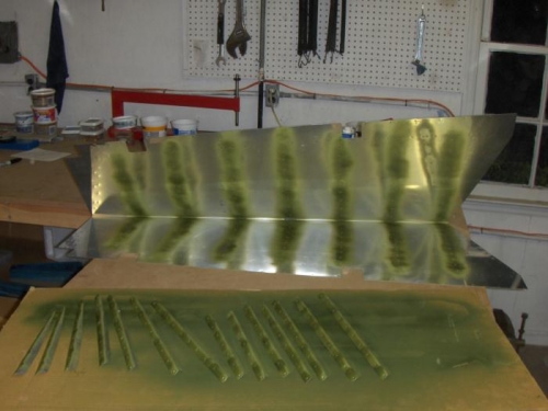

I started today dimpling the left rudder skin. Next I used Alumiprep on the skin and stiffeners, dried, and primed.

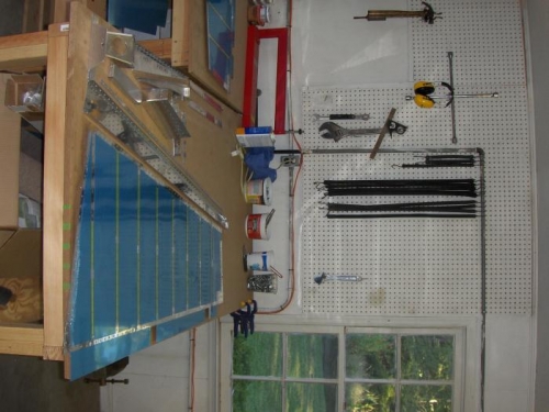

Even though I only worked 2 hours today, it felt like a great accomplishment. First I back riveted all the stiffeners to the left rudder skin. Then I started clecoing together the rudder.
I match drilled all the remaining holes for the trailing edge wedge, and skin to rib/spar attachments. I made the rudder horn brace and the attachment strips for the lower piece of fiberglass.
