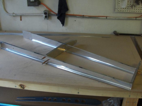

HS Spar Assembly - 2.5 hours
I assembled my front and rear HS spars today. For the rear spar, I squeezed every rivet. The first one was over squeezed a little, but I dialed it in on the second one and they all look great.
The front HS spar didn't go as smoothly. I ended up drilling out three rivets and re-doing them, and may end up redoing some more. Lesson learned for the day - Bucking rivets is not something to do by yourself, even if it does seem like a small job. I squeezed where I could, and bucked where I had to. I need a lot of practice, and I need a helper.

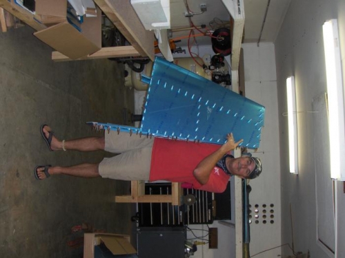

Started on the vertical stabilizer - 4.5 hours
Today we got started on the vertical stabilizer. Match drilled the rear spar, doubler, hinge brackets, and all spar-to-rib holes, deburred and edge finished the ribs, and got the skin clecoed in place. This seems to be moving much quicker than the HS - perhaps less parts mixed with more confidence? Here's a picture of dad holding up what we've got so far:
