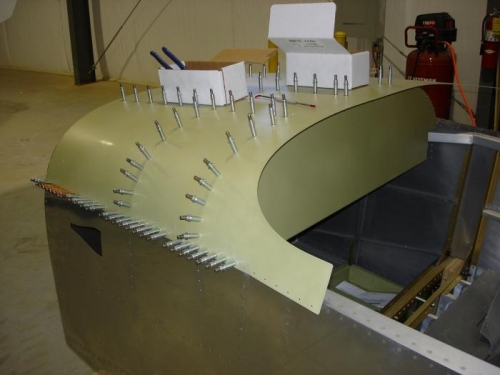

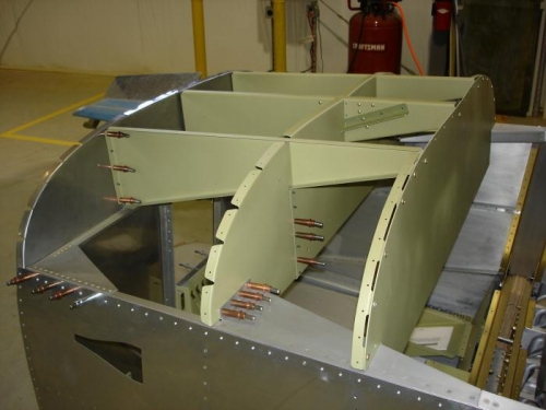

Brief Description:  Continued Forward Fuselage Deck
I continued working on the frame for the forward fuselage deck. I fit most of the pieces together, then clecoed them into the fuselage. I then attached the forward skin for match-drilling. I had to fabricate the two center instrument panel attachment angles and install their nutplates as well.
