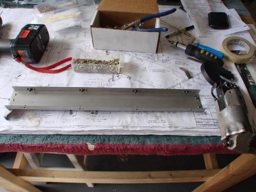

I finished up the installation of the electric flap motor/actuator.
I match-drilled the motor mounting bracket to the inside of the flap motor channel and then riveted in in place. I reinstalled the motor and actuator once the rivets were set.

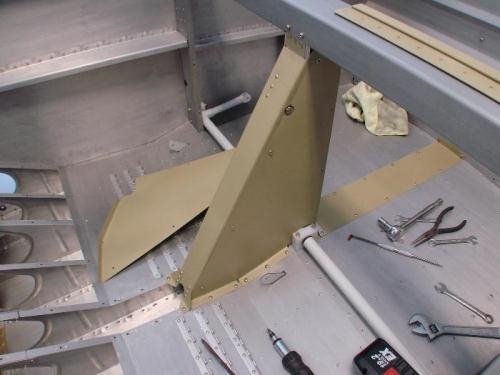

Also, the flap actuator covers had to be screwed in to match drill the backrest brace. Once that was drilled I installed the nutplates in the backrest brace where the aft cover screws would go. I also used a unibit to cut away part of the port cover where the actuator motor attach bolt came through.
