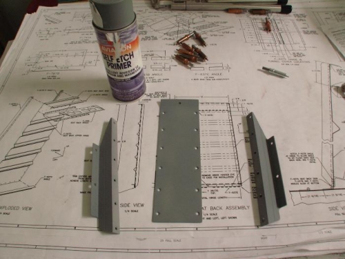

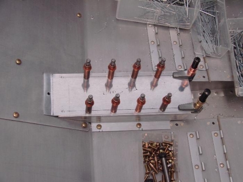

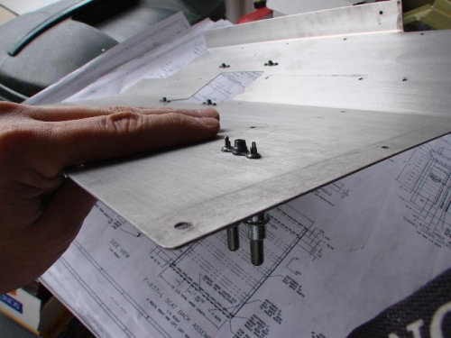

I clecoed the tunnel cover to the supports and attached them to the aft seat floors. After lining everything up, I drilled the tunnel cover and supports for rivets. I also installed the nutplate for the screw attachment at the front end of the tunnel cover.
I deburred and countersunk where necessary, then primed the parts for riveting later.
