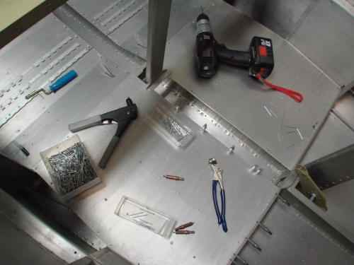

Brief Description:  Installed Bellcrank and Worked Baggage Compartment
A missing bolt I needed to install the elevator bellcrank came in, so I temporarily fitted and installed the bellcrank behind the baggage compartment.
I blind riveted the baggage compartment flooring and rear side covers and installed all the nutplates that were required here after drilling, deburring and dimpling the panels.
