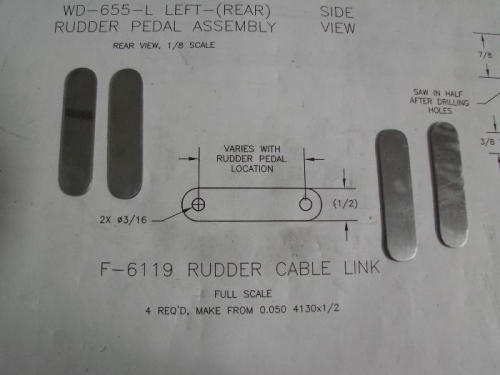

I fabricated the four rudder cable links that will be required for attaching the rudder cables to the rudder pedals. I'll drill the attachment holes later.

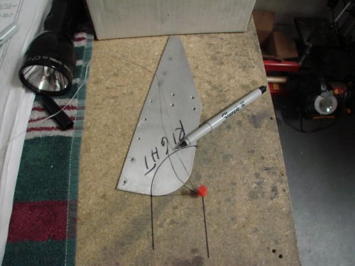

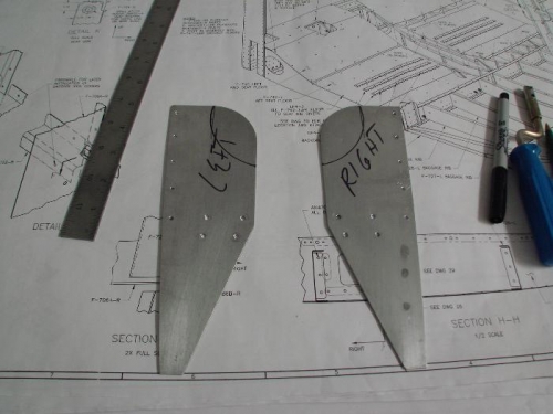

I continued through the slow-build plans verifying the pre-skin work up to the "fuselage and longeron details." Here, I began working on the canopy side rail gussets. Since I'm building a slider canopy model, these need to be trimmed. I measured and marked the 2" radius that will be cut from each gusset.
