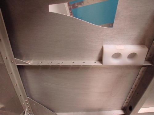

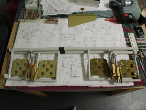

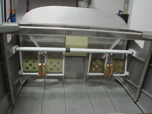

Brief Description:  More Rudder/Brake Pedal Work
After drilling the attachment holes for the brake master cylinders I bolted together the rudder pedal assembly. I also drilled the side bearing blocks in the fuselage to allow for three positions for the pedals (six holes per side). I then installed the assembly in the fuselage. The center brace still needs to be fitted and installed.
