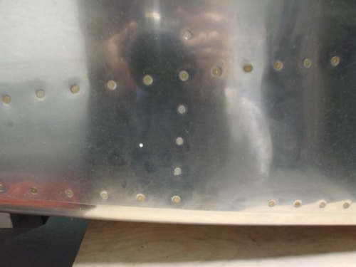

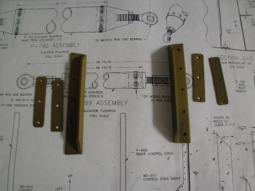

I moved on to finishing the forward fuel tank bracket supports. Several quickbuild rivets had to be drilled out for the stiffener installation. I then took the previously fabricated parts and fit/drilled/dimpled/countersunk as necessary. I removed them for priming and will reinstall them with clecos only for now.

5 rivets/side to be drilled out
Fuel tank bracket stiffeners
