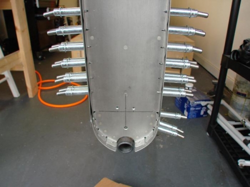

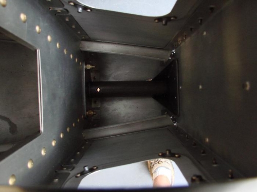

I finished installing and fitting the WD-409 tail spring mount by drilling the appropriate bolt holes and "keeper" rivet holes for attachment to the rear-most bulkhead. I made a shim to include with the attachment to provide a tighter fit for the tail spring mount between bulkheads. I'm going to have the mount powder coated before permanent installation and before riveting the bulkheads.

Tail spring mount temporarily installed
Outside view
Outside view
