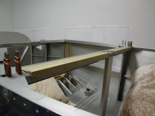

Brief Description:  F-705 Bulkhead and Checked Other Bulkheads
I drilled and riveted the F-705J Angle, F-705k Plate and F-705 seat adjustment supports to the F-705F Channel. I also started riveting any open holes in the F-705 bulkhead that had been left open for a tri-gear model.
Next I studied the plans and fuselage to make sure the F-706, 707, 708, 709 and 710 bulkheads were completed in the pre-finished work. Only a few rivet holes and snap bushings had to be taken care of. I also verified the longeron work shown in the plans was complete.
