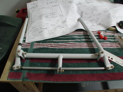

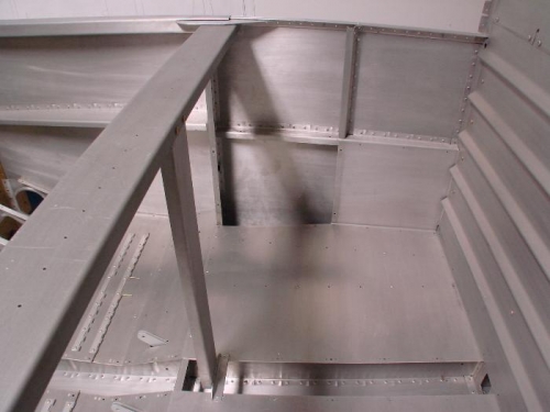

I located all the hardware and assembled the control column, sticks, and bases for a pre-fit to the F-704 bulkhead control column mounts. I began work on the F-705 Bulkhead, first by verifying all that Vans had done for the quickbuild. I removed the side inspection panels to do this. Several snap bushings had to be inserted, two upper bulkhead angles (F-705G) had to be removed since they were only for the tip-up model. A few of the upper bulkhead components will need to be fabricated, so I located the included materials to make them and plan to do that next.
