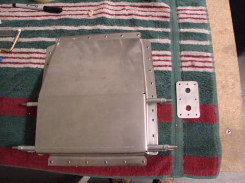

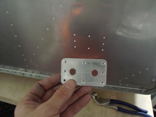

I fabricated, drilled and prepared the firewall brake line bracket and countersunk it for riveting. I also match-drilled the firewall recess to the firewall, then deburred and dimpled all the holes.
