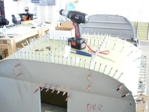

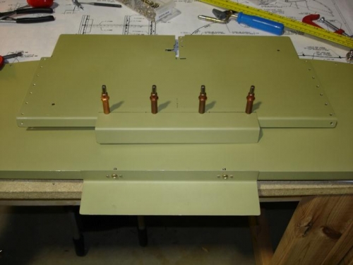

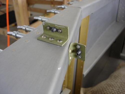

Brief Description:  More Forward Fuselage Deck
Today I kept working on the forward deck skin and panels. After all the ribs, panels and skin were on, I match-drilled the skin to the skeleton (and firewall) and drilled the holes for the various brackets/angles that had to be done while assembled (Oh what fun getting upside down under the panel in the fuselage!). I finished fabricating and adding nutplates to the instrument panel attach angles (2 per side) and installed them once everything was removed. I dimpled/deburred all the parts except the skin, and I drilled and attached the instrument panel and subpanel engine control brackets.
