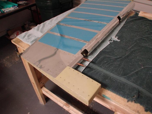

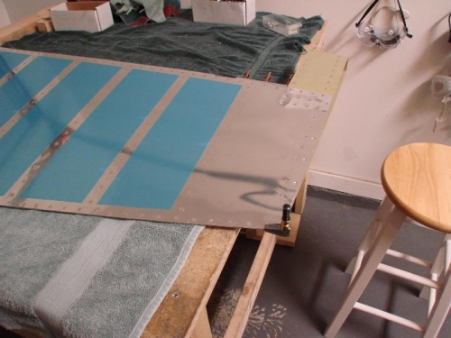

I decided to go back and work more on the rudder. Some of the finish details were not to my liking, but I think it's much better now. I used a hand seamer to straighten the trailing edge a little better, I drilled-out and re-rolled one section of the leading edge to better standards and I added a little more proseal to the top of the trailing edge where there was a slight gap. Everything looks much better now!
