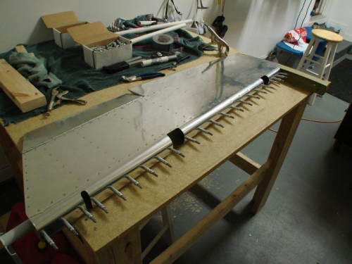

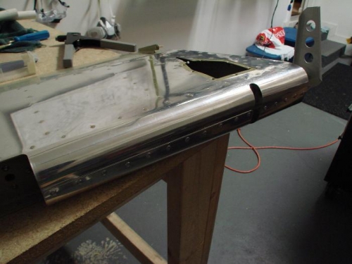

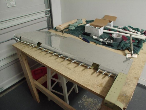

Date:  10-17-2008
Number of Hours:  1.50
Manual Reference:  6-13
Brief Description:  Rolled Leading Edges of Left Elevator
I finished blind riveting the skin in four places. Next, I used duct tape and both a steel pipe and pvc where necessary to roll the leading edges of the left elevator. I match-drilled all the holes and added more holes in between. I then pop-riveted the leading edge together except for one section where I ran out of blind rivets and had to order more.
