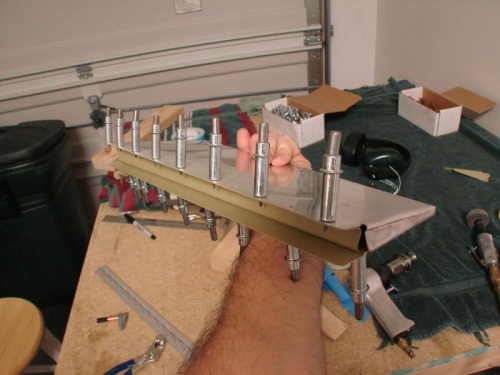

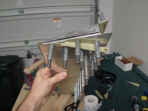

Brief Description:  Trim Tab

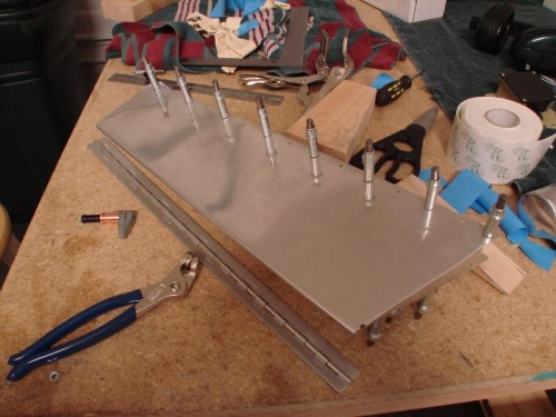

I started work on the trim tab by making the final bend in the control surface, then used the blocks I had already made for the elevator to bend (by hand and rivet gun) the end tabs of the trim tab. I match drilled the piano hinge to the tab and drilled the end tabs for blind rivets later.
