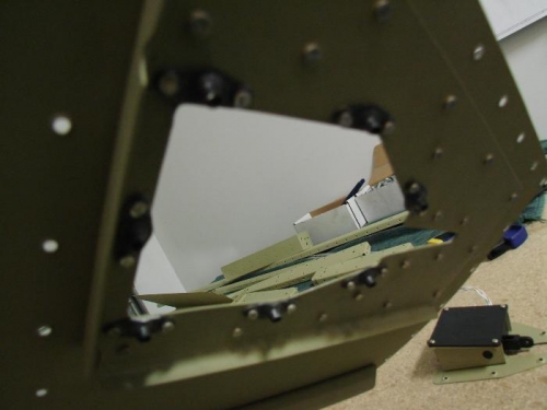

Brief Description:  Finished Trim Access Plate and Trim Tab Work
I finished up the elevator trim access plate by trimming one of the horn braces to fit and also trimming the edges of four nutplates to make installation easier. The scotchbrite wheel and die grinder worked great for this.
I started working on the trim tab area by marking the bends on the left elevator tabs. I fashioned a bending block set to bend the tabs with. I need to get two-sided tape to hold everything in place before bracing and actually bending.
