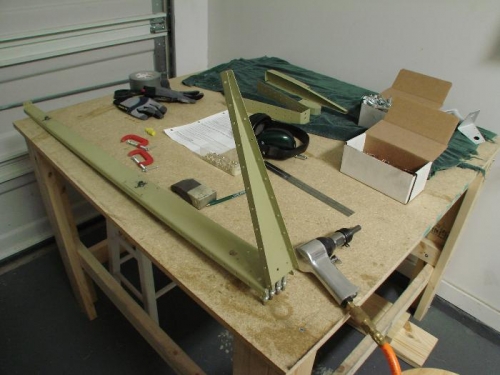

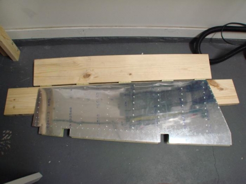

Brief Description:  Bent and Began Riveting Right Elevator
Susan helped me rivet the stiffeners inside both the right and left elevators. I then riveted the trim tab stiffener (E-615PP) to the left elevator and put it aside for later. I used the wooden bending break to bend the right elevator to its proper angle. Finally I started riveting together the right elevator, beginning with the spar reinforcement plates and nutplates.
