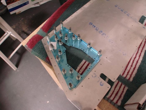

I finished the remainder of the stiffeners for the left and right elevators. I shaped them, deburred and dimpled them. I also deburred the elevator skins and scrubbed everything with a scotchbrite pad to prep for priming.
I also started work on the E-615PP trim reinforcement place by match drilling it.
