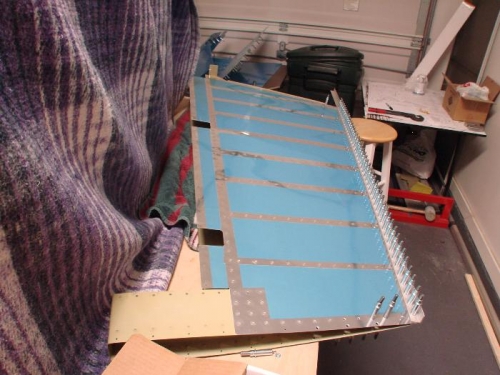

Brief Description:  Rudder Trailing Edge
I began working on the trailing edge of the rudder. I used the AEX trailing edge wedge to drill the rivet pattern into an aluminum angle. I then mixed Pro-Seal and applied it to both sides of the AEX wedge and clecoed everything together, including the angle piece. This should help create a straight, even trailing edge for the rudder before riveting it. The Pro-Seal will need to cure for a couple of days before disassembly.
