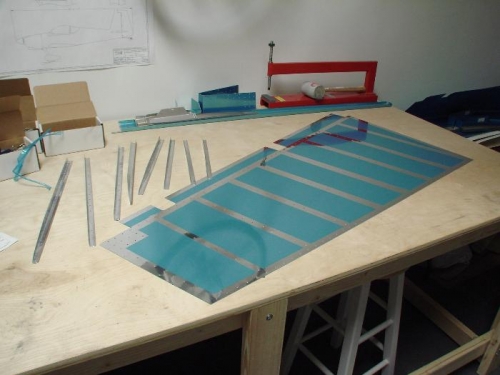

Date:  7-3-2008
Number of Hours:  2.70
Manual Reference:  6-5
Brief Description:  Edge-Finished Stiffeners and Match-drilled
I completed edge-finishing the stiffeners. I then clecoed them to the rudder skins and match-drilled all the holes. Finally, I used a soldering iron to remove the blue plastic from the rivet hole areas on the inside of the rudder skins.
