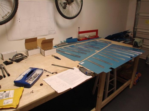

Date:  7-1-2008
Number of Hours:  2.50
Manual Reference:  6-5
Brief Description:  Prepared Rudder Stiffeners
I split the twin rudder stiffeners into their respective parts. I then trimmed the front of each stiffener to the correct length for its respective place on the rudder skins. I also tapered the aft ends of the stiffeners as shown in the plans so the rear of the rudder skins could come together for riveting. I began edge finishing the stiffeners as well.
