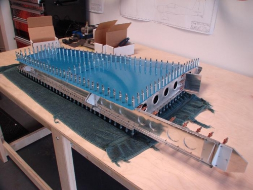

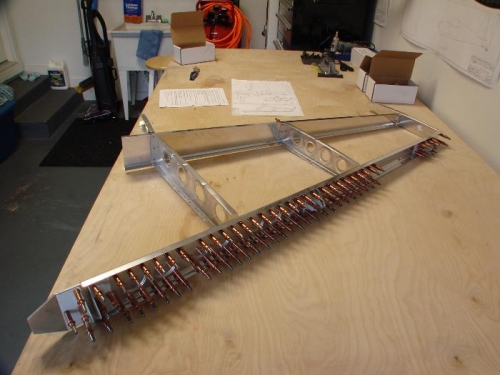

Brief Description:  Started Vertical Stabilizer
I started working on the vertical stab. I clecoed the stiffener and hinge brackets to the rear spar, then edge finished and fluted the ribs. Next, I clecoed the ribs to the forward and rear spars and match drilled the rib, spar and stiffener holes. I then clecoed the skin to the vertical stab skeleton.
