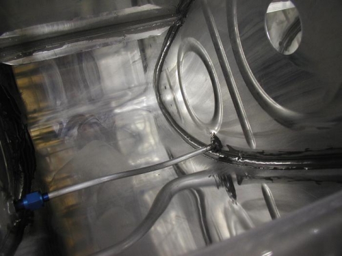

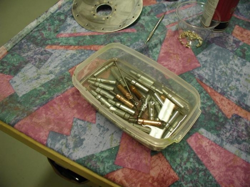

Installed vent line in tank and finished the end ribs. Cleaning some clecos in MEK to use them on the baffle in a few days.
The vent line where it will be pro sealed in place. Just below the fuel cap flange.
Cleaning the tank sealant from the clecos.
The vent line is attached with tank sealant at each rib for support.
