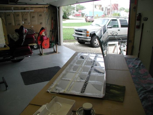

Started with the stiffeners on the lower skin tonight. I back riveted them in with the tank sealent. What a mess. Also preped the fuel tank drain.
The first row of stiffeners done

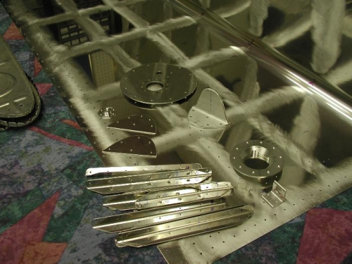

Cleaned all parts with MEK before sealing.

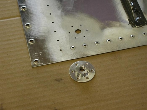

The fuel tank drain is readt to be sealed in place.
