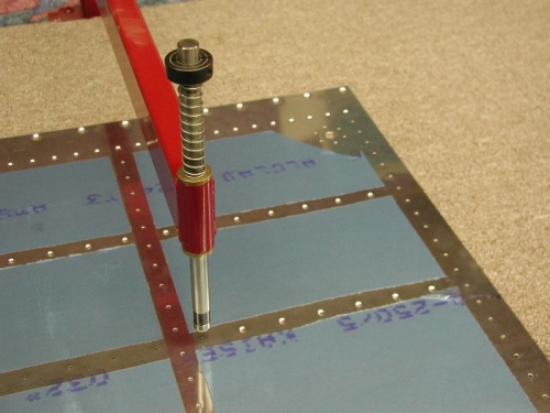

Finished all of the dimpling of the fuel tank. I used a fuel tank dimple from Cleavland Tool Co. It makes a bit deeper dimple for the 3/32 rivet to fit into the thicker material that Van's uses for there fuel tanks. Looks good. I am going to fabricate the small hinged fule trap tomarrow night and should be ready to start sealing. FFFFFFFun.
