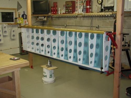

Worked on setting the wing in the jig tonight and made sure that it was straight and level. Checked for twist with a plumb bob. Lowered the plumb bob to the floor and made a mesurement from the string to the edge of the rear spar. Also drilled the wing walk support plate and started to attach the top skins.

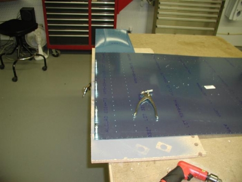

Drilling the holes in the wing walk doubler that is under the inboard top skin.

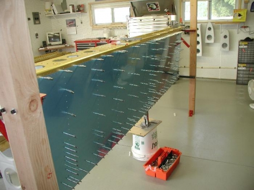

The top skins are clecoed to the wing .
top side of left wing with skins clecoed
