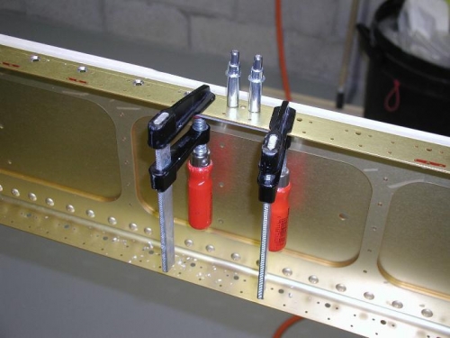

Made this small jig to prevent chatter of cutter. Worked great...
Here is how I held the jig. I removed the clecos and then did the mahining with out any chatter.

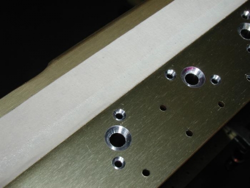

Nice clean countersinks with no chatter. Put tape over seams in spar to keep Aluminum chips out.
