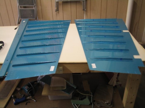

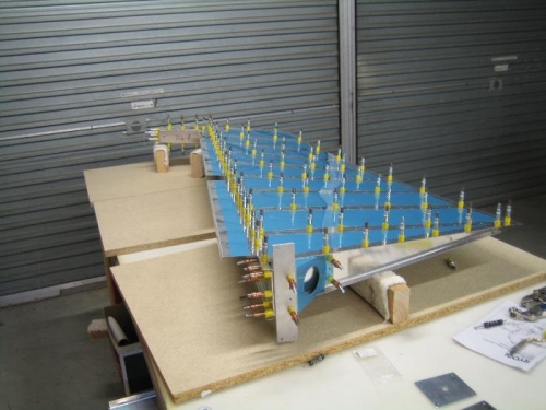

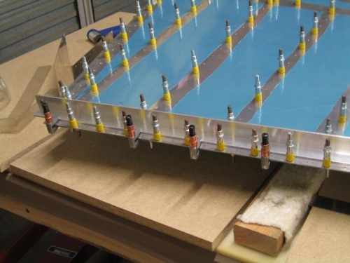

Started work on the rudder, shaping and fitting stiffeners and fitting the aex fillet to the trailing edge. Used a piece of aluminium angle to align the trailing edge and hold it straight and firm while drilling.
