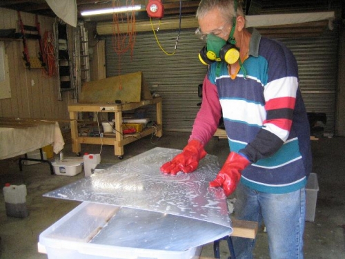

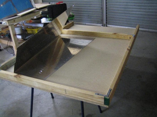

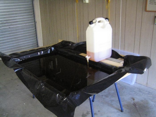

Built a "bath" out of chipboard and lined it with visqueen to give me a depth of about 20mm using 20 litres of alodine, Scrubbed the skins with Alumiprep, rinsed and then immersed them in the "bath, Rinsed again and ended up with a good finish.
The "bath" under construction
Scrubbing the skins
Filling the bath with Alodine
