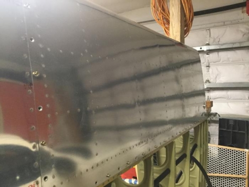

Assembled and riveted the RIght LE in the stand. Dropped the bucking bar inside and dinged the fwd edge on both the top and bottom. Need to address at painting.
Installed and riveted the R. LE on the Skeleton. Used LP4-3 and LP4-4 instead of solid rivets on the Rib to Main Spar holes. PAINFUL trying to get in there even with a pneumatic rivet puller, but it is done!

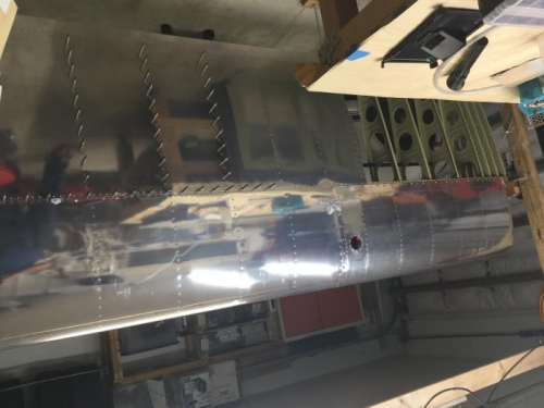

Installed the Fuel Tank and put bolts in every other hole joining the skin to the Main Spar and LE-Tank Filler. Used ALL bolts on the Z-Brackets. They were tough to get started, but all went in.
