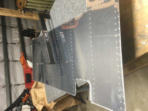

Brief Description:  Dimpled R. Wing Skings, Gap Filler
Dimpled all four Right Wing Main Skins. LE Skin, LE-Tank Filler strip, Access Cover Plates, and Wing Walk Doubler.
Made my first figure 8 while dimpling. Missed my first strike and flinched. The LE Skin moved a little after I flinched, then I hit it a second time and made the 8. I called and emailed Vans. Kevin recommened flattening the unintentional dimple, then dimple the original dimple. During finish work later, I'll just fill the small hole with fiberglass filler prior to painting.
Dimpled all Right Wing Skins
Figure 8 Ooooops
Figure 8 Ooooops
After Repairing Dimple 8
