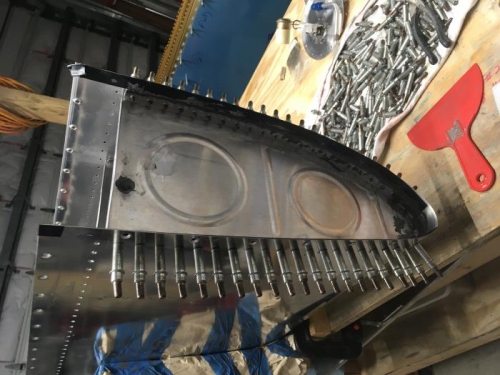

Prepped all remaining parts for Right Fuel Tank including washers, fittings, nuts, Baffle, Rib 7, Sender, Pickup, End Plates...
Sealed and clecoed Rib 7.

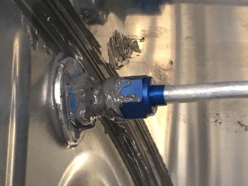

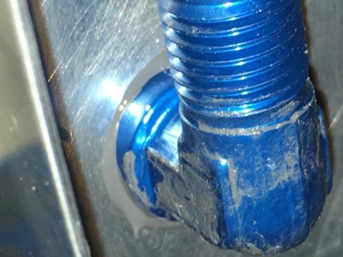

Sealed and torqued (60 in-lb) both nuts on Vent. Added a little sealant between tube nut and bulkhead nut.
Rib 7 - R. Fuel Tank
Vent - R. Fuel Tank
Vent - R. Fuel Tank
