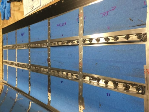

Brief Description:  Riveted R. Fuel Tank Stiffeners
Riveted all Right Fuel Tank Stiffeners with Proseal. Used 77 grams of Proseal in two batches: 40g/4g and 30g/3g (10-1 mix). Temp was around 75-80 F. The masked off areas really helped with keeping it neat and allowed me to use the sealant scraped up while filleting the sides, to cover all the rivet heads. Came off the back riveting plate three times. No significant damage was done luckily. SLOW DOWN!

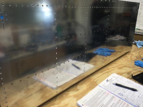

First seven Stiffeners installed
Outside View of First seven Stiffeners
Close up of Typical Stiffener
