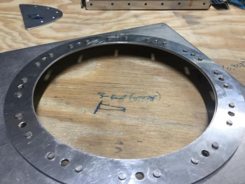

Clamped and drilled Nose reinforcement plates (T-410) to both the Inboard and Outboard Ribs.
Match drilled holes in T-408 and T-407. Dimpled Inboard Rib for T-407. C/S T-407 for rib dimples (-.007 to -.008 below flush). Riveted T-407 to rib.

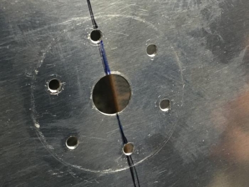

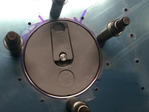

Opened up fuel cap hole with scotchbrite wheel until cap just fit into hole. Then used reamer to size all holes.

T-407 Match Drilled and Riveted
Right Fuel Cap Hole Modified and Match Drilled
