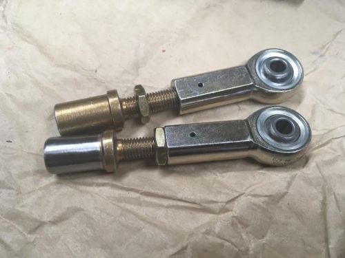

First, cut the Aileron to Bellcrank pushrod in the wrong place, TWICE. Ordered a new one. Used a rule that had 64ths, and needed 32nds, and used 15/64 instead of 15/32 or something similar.

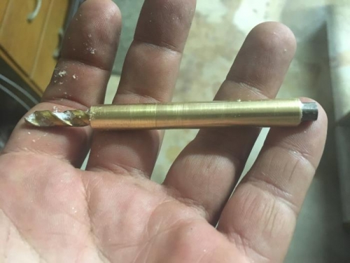

Then I got my drill bit stuck in the brass bushing trying to drill it out. Didn't used enough Boelube I guess. Ordered a new one, but eventually got it unstuck and installed.
Then I found out the bearings don't fit into the end of the Aileron to Bellcrank pushrod. I sanded a little in the tube, and a little more on the insert. STILL won't go in. I didn't want to force it since I'm waiting on a new pushrod. I'll research some more...

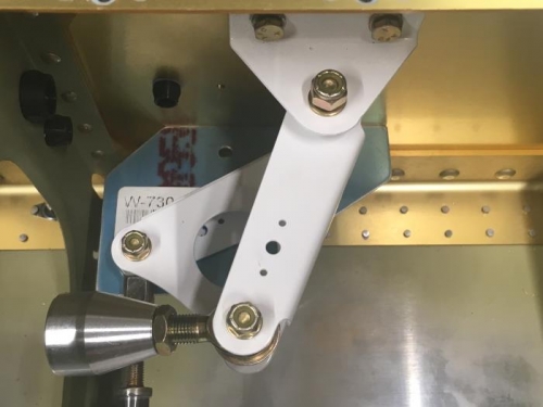

Managed to rough in the Bellcrank and alignment jig. Seems to work very smoothly without anything tightened down. I need to make sure I get the Roll Servo for the Autopilot before I close up the wing, so it will be easier to install. Just going to clean up the wing and put it in storage.
