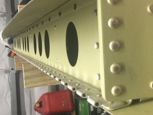

Finished the Right Flap.
- Riveted the Spar and Hinge
Used the my homemade angled pull rivet tool. Worked well. Left a little smile on the rivet heads, but not bad. MUCH better than not using it.

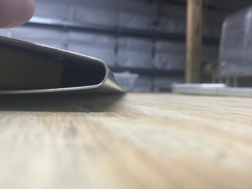

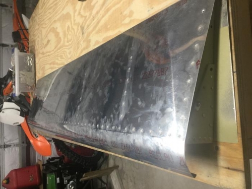

Checked twist. The Left Flap was almost perfectly flat. The Right Flap had a little less than 1/8" twist/rocker.
Right Flap
Right Flap - 1/8* twist
Right Flap Top Skin
