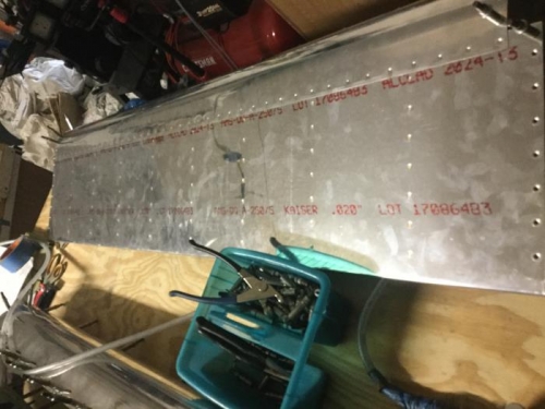

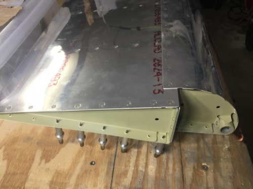

Brief Description:  Left Aileron - Riveted top of skins, Nose Ribs, an
Dimpled the Nose Skins into the Counterweight Pipes of both Ailerons. Used hammer and C-Frame Dimple Holder. Not perfect, but looks good enough. We'll see what happens when I install the pull rivets.
Riveted the Nose Ribs, Main Ribs, and Top Skins to the Spar on the Left Aileron.
Left Aileron Top Skins Riveted
Clean riets of Top Skins of Aileron
Left Aileron Ribs Riveted to the Top Skins and Spar
