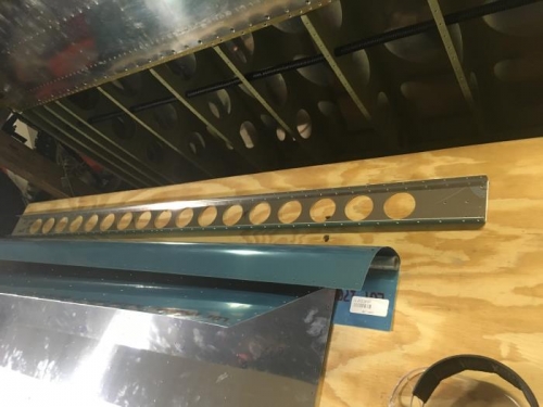

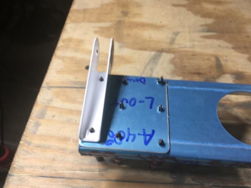

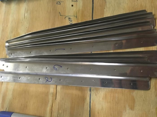

Started the Ailerons today. Separated, shaped, and smoothed the edges on all the Stiffeners. Smoothed the corners on the Spar ReinforcementPlates. Match drilled them and the Stiffeners on the Left Aileron Skin. Fluted the Nose Ribs.
Need to Match Drill the brackets with #12 bit (for the bolts) and catch up the Right Aileron to this point.
Both Aileron Stiffeners
Aileron Bracket and Reinforcement Plate Clecoed on.
Parts of the Left Aileron
