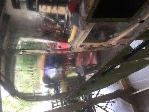

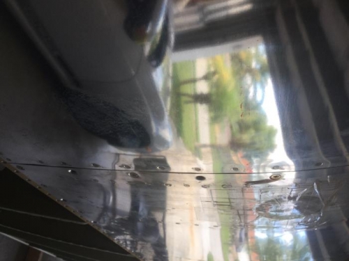

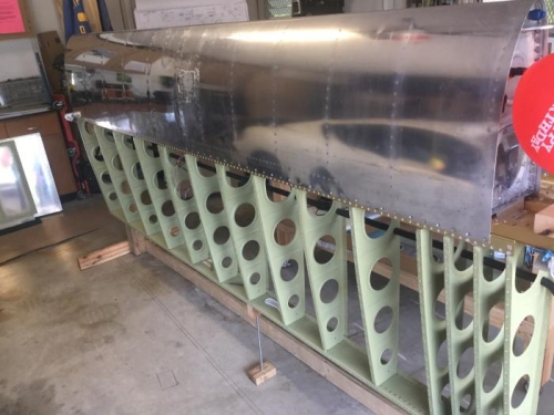

Brief Description:  Left Wing Installed Fuel Tank
Installed the left Fuel Tank using every other hole for the screws and bolts. The bolts on the Z-brackets took a little coercion to align them, but not much. Also the skin to spar hole next to the Leading Edge was very difficult to get flush. Never got it quite flush, but not too bad. Had to countersink the topside hole a little to get it to fit better....
Good news, it seems to be holding air still!!!!!!!!
