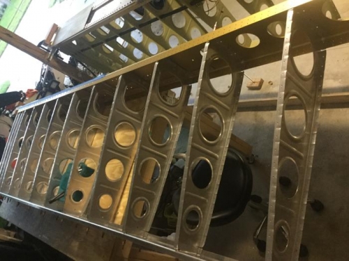

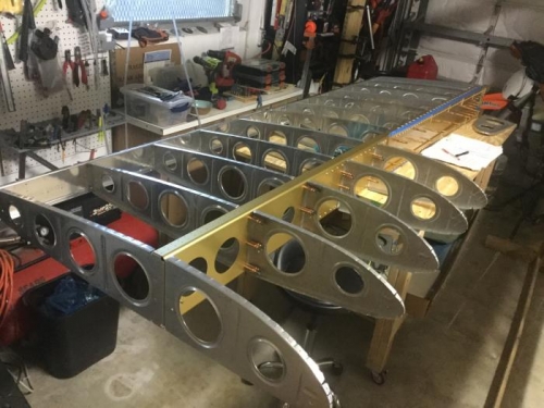

Brief Description:  Prepare Right Wing Ribs for Priming
Clecoed Right Wing Ribs to Main and Rear Spars. Match Drilled all holes and added the extra holes on the 5 ribs that need them per the drawings. Deburred all holes.
Need to open the tooling holes to allow wiring to run to the tip.
